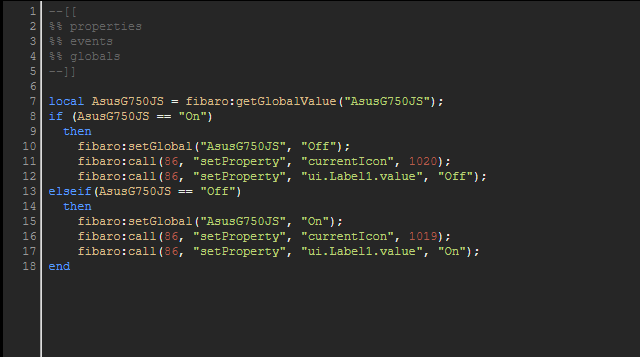

         3. The python scripts are very basic, they are just a http get on a hc2 scene that sets a variable of the status
          4. This is the scene that is being called (I know it's messy code and must be improved)

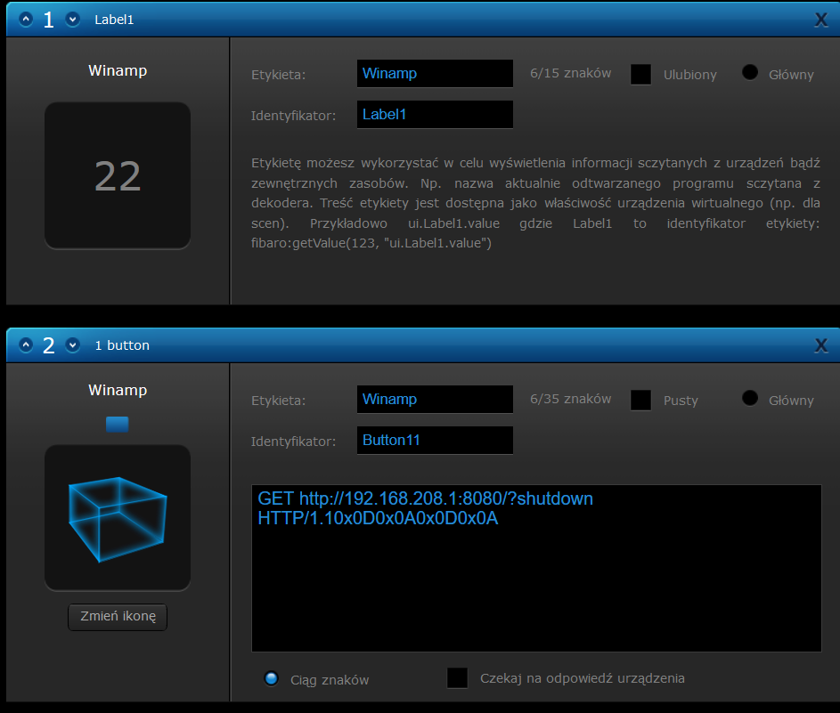

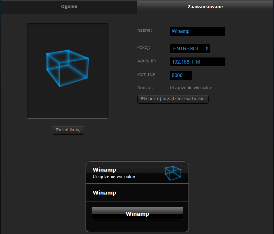

    Since it can be done through http, now we can use VD button to directly trigger EventGhost macro.  Here is an example (basic code to make it work) of Hibernate button.
    and for VD configuration you need to enter your target PC IP and Port (eventghost port default 1818) on General Tab.

    I can now tell that this method wroks for Home Center lite:
    192.168.1.16 my laptop
    8080 port TCP
    Code:
    GET http://192.168.208.1:8080/?shutdown HTTP/1.10x0D0x0A0x0D0x0A
    In my case this http request is starting a Winamp and Totalcmd in my computer. It can start anything else just pick it from eventghost (start a program, shutdown computer, lock computer, hibernate, log off, Python Scrypt, Webserver ...) :)
    Ps. I have shutdown Autoremote with Chrome and it also works :)
    In order this to run you have to had installed webserver plugin for eventghost. I have instal it with port 8080
    Edited by pjjarzembowski
