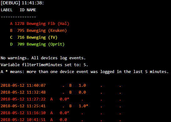

    I wonder if you have 15 minutes to use my script to display all event data from that station in the debug log. The output looks like this and is easier for me to read. Here are for example 4 motion sensors:

    I was a bit lazy. I am alwais query manually like a:
    /api/panels/event?deviceID=933&last=100&type=id
    and after
    ;) Hahahaha
    Thank you!
    so, as we can see at the night - 22h (I mean it's not night it evening), 03h and 5h cuz dawn.
    ше make sad me.
    during the winter (guess) it will feel even sadder! 22h / 3h / 7h
    Thanks! So this is a truly a "sunny weather only device". :?
