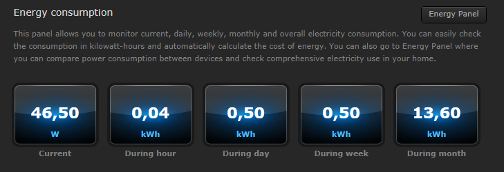

I think the left value (46.20W) is the current consumption value but I didn't get the second value(94.99kWh). I've checked that with the Energy Panel values as shown in the following picture but It didn't match any of the values.
So the question is for calculating the energy consumption which value should I send to my database and at which intervals(i.e. every fifteen minutes)
