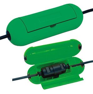

    Expensive, you can also take a NeoWallplug and pack it in a protective cover.
    NeoWallplug €20,= Wish.com and protective cover < €5,=.
    /monthly_2018_09/neowallplug.png.6ffd4b219ca4cf1b61cd2d35d716d7b5.png" alt="neowallplug.png.6ffd4b219ca4cf1b61cd2d35d716d7b5.png" />944057009_waterdichtedoos.jpg.88e207cfddb69cde066c456250050328.jpg
    @FonsBrand can you provide a link on second item - protective cover
    thanks!
    Water will get in... Product is not suitable for outdoor use. Not even in such a "protection". Thermal cycling sucks in moisture. Creepage and Clearance isn't enough for this application. 230 V will flash over to the components and destroy the plug. If you are lucky, it flashes over to protective earth and trips your RCD. Not that people EVER listen to me when I talk about electrical safety... But hey, I can try...
    thanks!
    @10der
    Hornbach:
