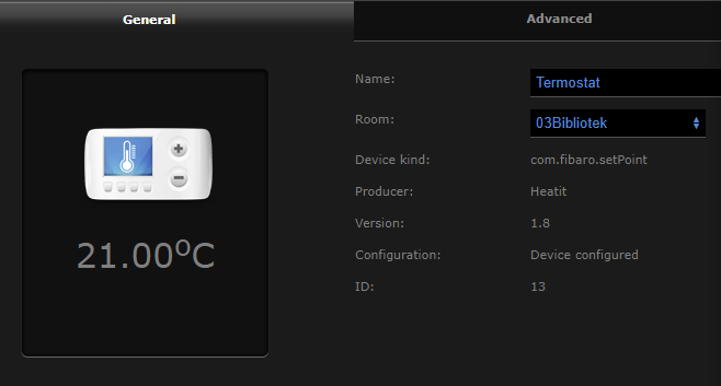

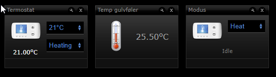

The thermostat says 21C, even do the Heating panel is set to 23 and when i set the manual mode to 12C in the Heating panel nothing happens with the temperature of the devices:
/monthly_2018_10/image.png.fbd1a95140178fca5111a211aee3f9fe.png" alt="image.png.fbd1a95140178fca5111a211aee3f9fe.png" />
The thermostat stays at 21C
Is there a bug in firmware 4.510 or am I doing something wrong?
When I try to change the temp to e.g. 15C it seems like Parameter 10; CO mode setpoint is changed, (I have to do a "Read configuration" to see the change i CO mode setpoint)  and I can't remember it doing that before i updated to firmware 4.510
