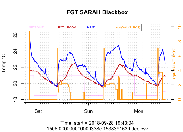

    This is an example of FGT controlling room temperature.
    Does it work with your algorithm? When do you turn your boiler on and off?
    This data was extracted from black-box, so it has valve position. That is not available via Lua.
    /monthly_2018_10/GOETZ_BIG_04.png.e6133c5384f0f4b51577af906b1da7fe.png" />
    And this one:
    Before you say: ROOM overshoots but this room has a south facing window, so the valve closes but the sun has enough power to heat an extra 0.5 - 1.0 °C.
