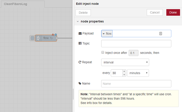

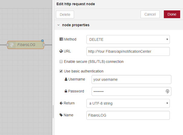

    Simple solution that deletes all logs every 30 minutes
    /monthly_2018_10/image.png.9f5213cbc018b0d6c382ff955ca0480d.png" alt="image.png.9f5213cbc018b0d6c382ff955ca0480d.png" />
