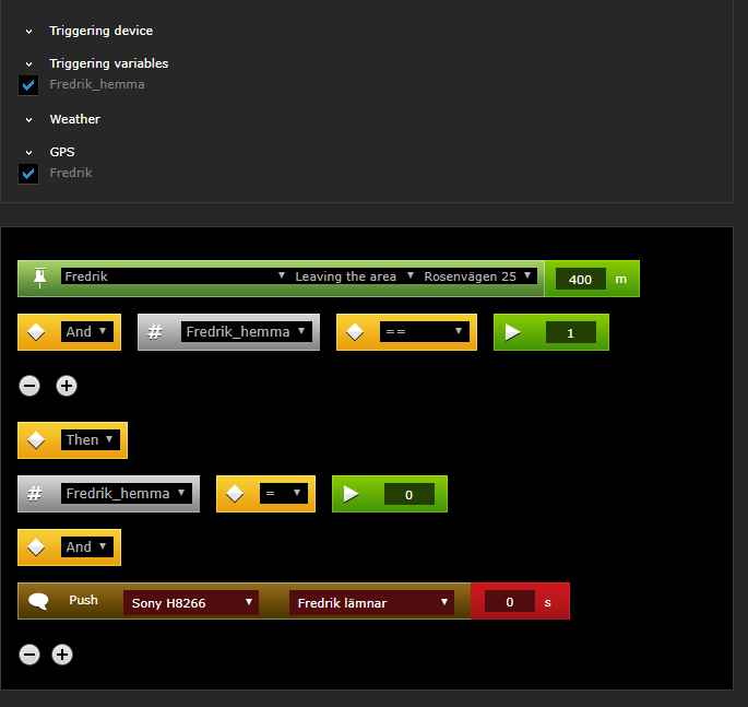

How can this scene (only the first pic) get too many instances?
It should only fire when BOTH criteria are met? The first running of the scene sets one of the conditions as false (variable == 0) then it should´nt fire again? What am I missing?

If I have understood your scenes correctly.
1) When you go out, a scene must run.
2) When you get home, the other scene must run.
3) The scenes should not be triggered by "Fredrik_hemma", so you must remove the selection in both scenes.
4) Even though the selection has been removed, HC2 will still check if the criterion matches.
Hope it will solve the problem.:)

    Thank you!
    I shall try!
