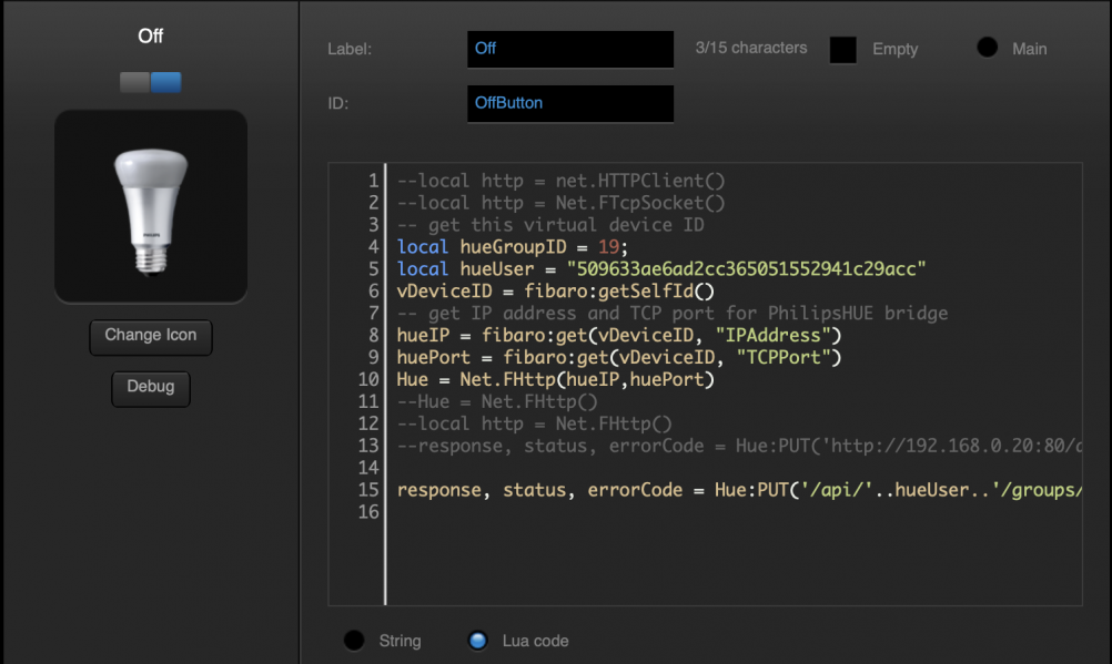

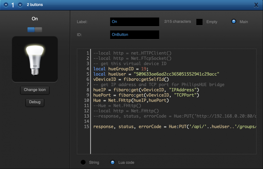

    Hi, is there a way to use this script with Philips Hue VD's?
    Seems this script is what I was looking for, hopefully it can work with VD's with 'On'  and 'Off' buttons.
    thx for all the work!
    idk. :) I haven't such devices. :(
    yep.
    welcome
