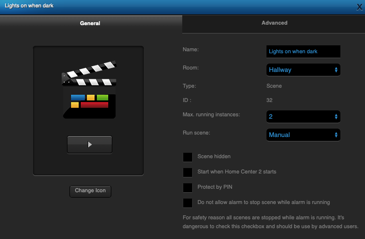

5) The scene "Lights on when dark" is only called by the "Front Door Opened" scene, no triggers, it shouldn't run at any other time.  The purpose of this scene is "if IsDark=1, then turn on some lights [else do nothing]".
But I find that the lights turn on every time I open the door, regardless of the IsDark value.  The "If" in the scene "Lights on when dark" is completely ignored, the lights always turn on.
/monthly_2018_12/image.png.c57ba6bc9fc2545cadda0b5154472201.png" alt="image.png.c57ba6bc9fc2545cadda0b5154472201.png" />
As you see, I added IsDark2 (a Predefined variable) as an experiment to see if it makes any difference.
Please can somebody tell me why this scene ignores the variable and ALWAYS turns the lights on regardless of whether IsDark and IsDark2 are set to 0 or 1?

When you call a scene from another scene, the "if" conditions are ignored, so programming works.
To make the scene work, you should:
1) Activate automatically so that the scene is triggered automatically.
2) Insert over "Then"  -  frontdor "breaked" and mark with the fly in triggering
Now the scene will run when frontdoor is breaket and isdark = 1 and isdark2 is = 1
You may need to delete the other scene, "front door opened". :)
    Hi and mange tak @hTiger1 that's very helpful.  I did not realise that the "if" conditions are ignored when you call a scene from another scene. Of course, that explains the behaviour I experienced.
    I updated "Lights on when dark" to include the "front door = breached" condition and set it to automatic, with the front door as a trigger.   I kept the other scene, "front door opened", because I want it to send me the notification regardless of the value of IsDark.  I removed IsDark2 from all scenes.
    Did this by remote admin and will test it when I get home later.  Thanks again!
