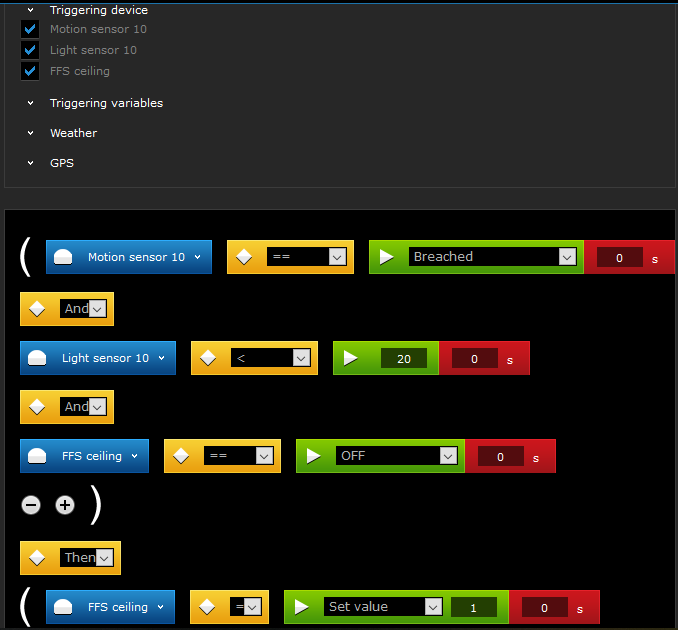

I've read everything i can find on the too-many-instances error, and have followed the advice in a PDF to set most scenes to max one running instance; however, i am still getting frequent too-many-instances errors. Below are two examples of very-simply scenes that give me the error. They are set to one max running instance. I only use block scenes as i can't write LUA code. Any ideas what is going on?

@europa, your scene with water would probably require more instances, because it could cycle and hence action could not be done. If it cycles, it creates new instance. So i would probably go with 3 - 5 instaces in this one, just to me sure.
In 2nd scene i would remove Light Sensor 10 and FFS Ceiling from Trigerring device (checkboxes above scene editor), since it gives me felling, that scene has to be triggered at armed and breached sensor. It can stay in scene, but not as Trigger. With that you should minimaze 2nd scene to 1 or 2 instances.

    @jakub.jezekIf i uncheck the Light sensor 10 and FFS ceiling triggering devices, will they not be ignored as conditions for triggering the scene? If not, why are the checkboxes automatically ticked? Is there a better (more efficient) way of writing this (and similar) scenes?
    @europa, they will not be ignored in scene condition. They just will not trigger scene. Scene will be triggered only by sensor, when breached and armed. I have tested this with predefines variables in one or two projects.
