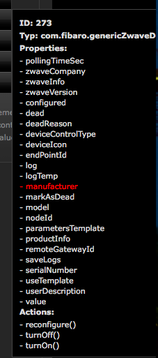

1. Pair the device to my FIbaro HC2
With this you will end up the 7 devices. The first one is the master, 1-6 represent the IR ports.
/monthly_2019_01/1..png.59567650f22ccf8e41bef6157fd222a6.png" alt="1..png.59567650f22ccf8e41bef6157fd222a6.png" />
