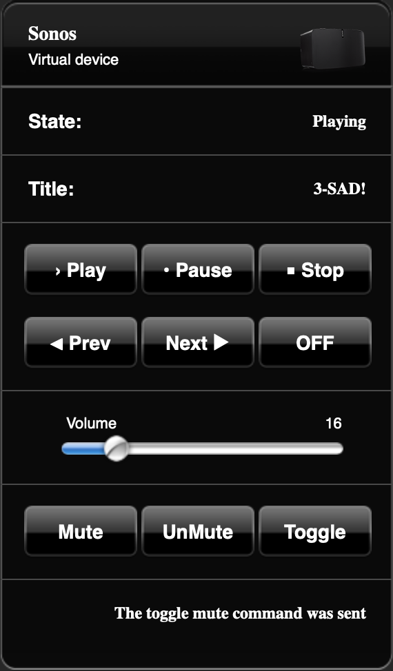

    Btw, here is a printscreen of my module. What I need is a LUA script to virtually push the "Play" button.

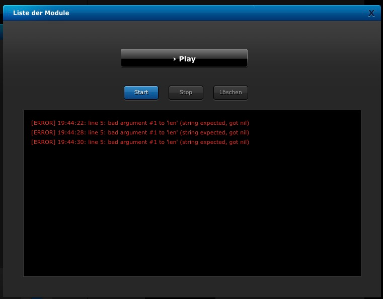

    @Krikroff: this is the error message:
    [ERROR] 23:21:19: line 5: bad argument #1 to 'len' (string expected, got nil)
    in the debug of your "play buton" or debug of Sonos VD ?
    @Krikroff No, in the script. In the debug mode I receive that:
    /monthly_2019_01/image.png.d0ba5712e3441ca6f769fd2b503cd8d2.png" alt="image.png.d0ba5712e3441ca6f769fd2b503cd8d2.png" />
    Thank you for your help!
    Dan

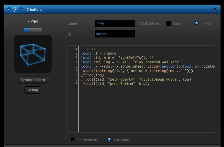

    Now I tried your script above:
    (28 is my VD-ID). And the following error is shown:
    Quote
    [DEBUG] 20:55:19: 2019-01-16 20:55:19.343511 [ fatal] Unknown exception: /opt/fibaro/scenes/34.lua:13: attempt to call method 'log' (a nil value)
    I mean I commented out the two lines with the log-variable, but I'm sure there is an idea behind them.  :-)
