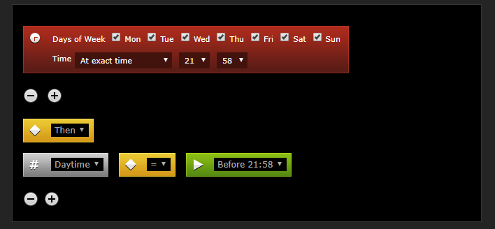

    Ok, so now according to the screen shots down below my lights are turning on if the time is before 21:58 and the sun is down?

    That doesnt’t work. At 21:58 you change the variable to before 21:58, that time is already past. You don’t need a variable before 21:58.
    Before 21:58 is the same as after 06:00
    This is what you need.
    1. A scene that changes every day of the week the variable at 06:00 to value after 06:00
    2. A scene that changes every day of the week the variable at 22:00 to value after 22:00
    In the last screenshot you have provided you need to change the variable to after 06:00
    It should work. You just need to play with scenes to get understand it better.  Sometimes it's better to first write down the scene on paper, after that you make it in Fibaro.

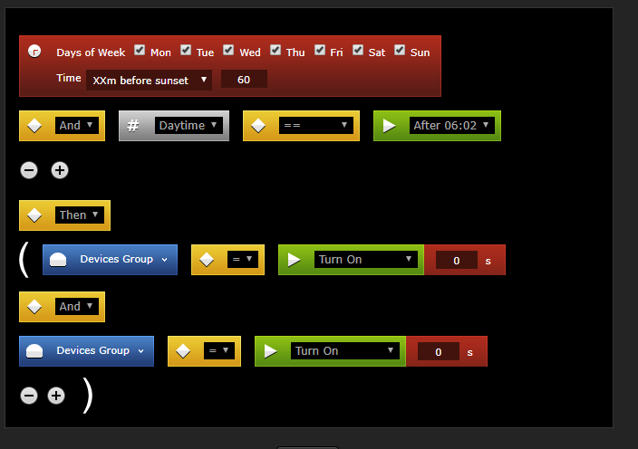

    So I should make it in the other order? Like this?
    What I want this to do is, if the time is between 06:02 and 22:00 and if the sun goes down or if the sun already are down during this time I want the lights to turn on 60min before the sunset.
    /monthly_2019_01/image.png.648fdedca157d0efdb41ae91716fea12.png" />
    1. A scene that changes the variable at 06:02 to value after 06:02
    2. A scene that changes the variable at 22:00 to value after 22:00
    3. Scene in screenshot below
    /monthly_2019_01/image.png.676d094f0349f9f1cbb2e49589dd0887.png.6231e4b3cc790f03636c21acea02ecb0.png" alt="image.png.676d094f0349f9f1cbb2e49589dd0887.png.6231e4b3cc790f03636c21acea02ecb0.png" />
