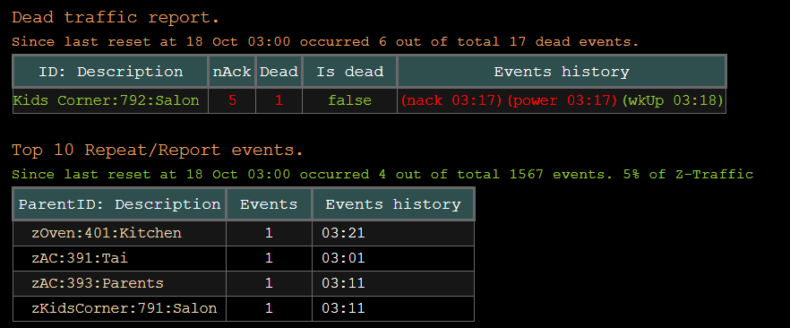

@amilanov
I saw that you have downloaded All-in-One Scene. May I suggest....
Please run it constantly (even as is without adding anything)
It monitors "Dead" and RPT (Repeat/Report) and overall Z-wave traffic.
If RPT is over 10% it's a problem, probably your devices configured to report too much data.

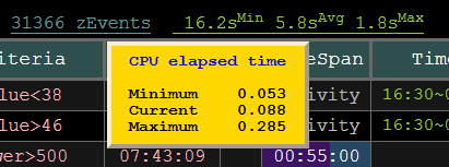

CPU elapsed time should be low as well.
If you've any issue with above then run Z-wave monitor to get more detail information.

On 10/18/2019 at 1:32 AM, cag014 said:
@amilanov
I'm already running zwave monitor twice a day (first thing in the morning and then again in the evening). It's bl**dy genius!
My system has stabilised again. I'm not going to say as stable as before the upgrade/downgrade, it needs more days testing, but it's WAY better. Woo hoo!
In case it helps anyone else this is what I did:
1. mesh rebuild entire network several times
2. manually wake up any dead nodes
3. soft reconfigure any devices reporting issues in @cag014's brilliant zwave monitor
4. individually rebuild the mesh of devices reporting issues with zwave monitor
5. here's the big one - tightened the antenna on the back of both my HC2 very tight... yes, this appears to have made  difference. After this experience I'm looking into buying a better omni-directional antenna to upgrade to - I've read lot son the forum but can't find specific product links, does anyone have any ideas?
6. Somehow, please don't ask me how as I don't know how, my lan settings on master and slave HC2 were set to DHCP not Static IP. Changing this BACK means my HC2 were not losing access to the internet and hence not "dying" each time my router was being rebooted or with intermittent internet connection drop-out issues
7. i then deleted all old scenes and vds - general house-keeping
Steps 3 & 4 alone wiped out 30-50% of my zwave traffic!
