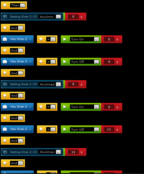

    Hello Jan,
    I included parameters required in scenes too into the VD above for Neo Siren. I made a scene where the volume of siren increases then decreases  at given time intervals.
    Check out this screenshot:
    I cannot copy the whole screen here but I hope you get the idea :-)
    Good luck!
