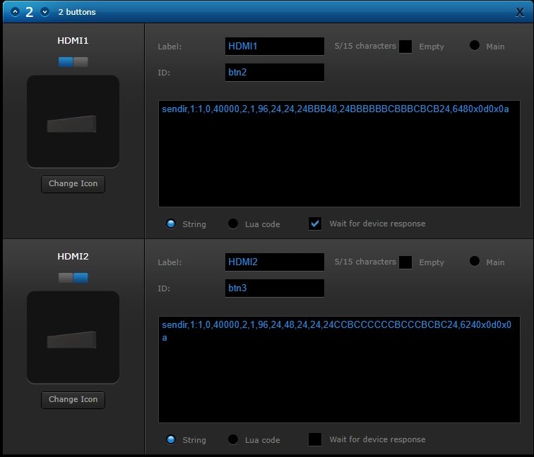

Hello,  I have the following VD to control Sony HT-Z9F soundbar, each individual button is working fine if pressed manually.
/monthly_2019_03/Z9F-VD.jpg.00d055a4f7273d3750b0032f5a34070d.jpg" alt="Z9F-VD.jpg.00d055a4f7273d3750b0032f5a34070d.jpg" />
I would like to press HDMI1 or maybe 2 in a scene.  It looks like fibaro:call(vdID, "pressButton", 2) is not doing thing correctly.  Is it because it is a 2 buttons per line?  If so, what is the lua code to press HDMI1 or HDMI2 correctly?  Thanks!

Hi @Sirhideo,
Try following format:
In your case:
Best regards,
Jakub
    @jakub.jezek
    Oh, didn't know button id can be used, thank you very much!
    One tip. In LUA programming in HC2 it's about IDs, not names.
