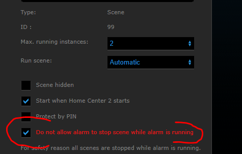

    Dont forget to check checkbox in the header of the scene:

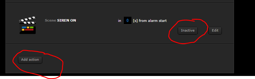

    "Add action", select this scene in the list and activate this scene in Alarm panel:

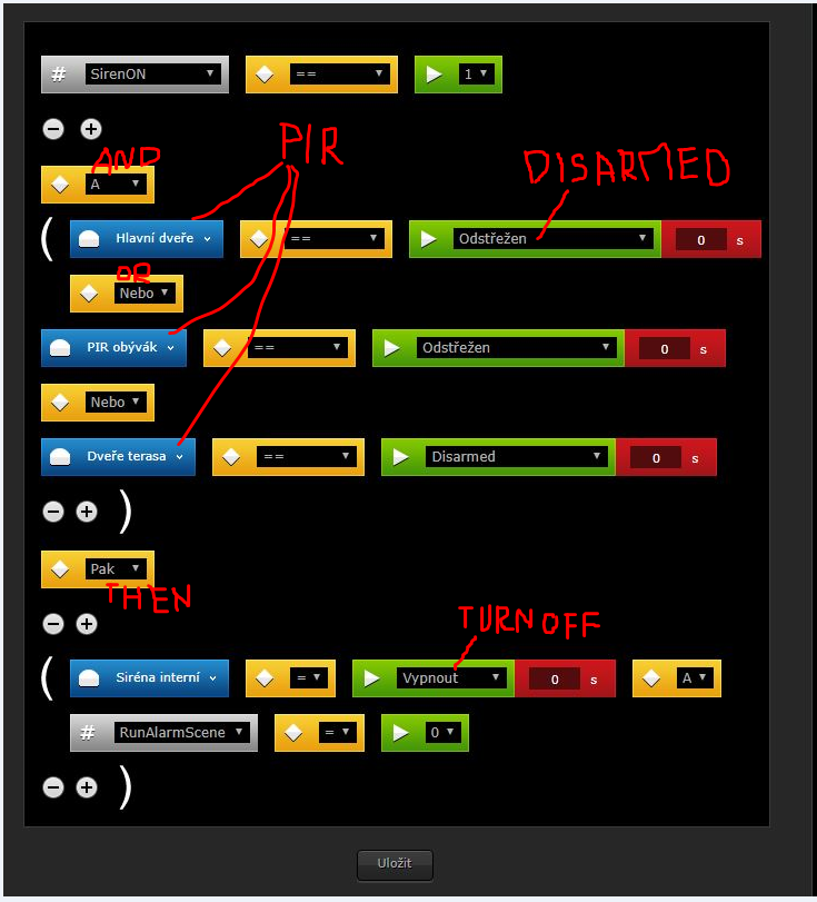

    Turn OFF sirene - when one of the security deviced is disarmed:
    PIR = some security devices (PIR, magnet, etc.)

    @dobsovicj Automatic siren off when alarm disarmed --> how to seteup the variable "SirenON" and "RunAlarmScene" ?
    Only like this (image below) ?
    And after I create the scene you give me with this variables and that's all ?
    /monthly_2019_04/image.png.5a4e8f354c9220526dfd63fc3f535e4b.png" />
