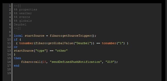

i'm trying to make a scene with a variable that i push true Domoticz called doorbel every thing wend fine but the state is ON or OFF
/monthly_2019_04/Knipsel1.JPG.cd66fb6f45d2222990347d4f3026db35.JPG" />
but the only thing i can insert is a number and not on or off
how do i change the state on or off to a value (tonumber) ?

I dont know much about block scenes. But you can try line 11 in lua code without tonumber function:
(fibaro:GetGlobalValue("Deurbel") == "on")
