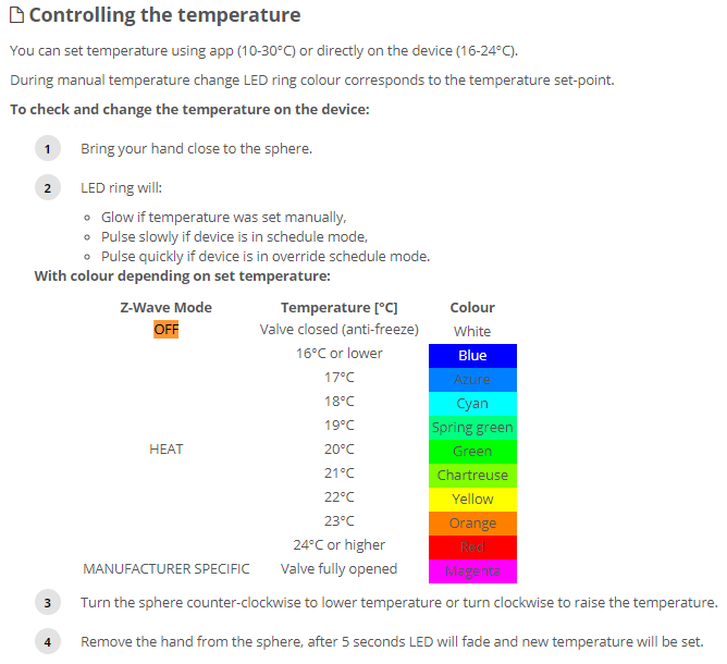

There are 2 hidden icons for the Heat Controller, I have shown them in the picture. One icon can either be Heat or Off, maybe you can just choose this off.
One can also just set it at eg 10 degrees.
Is there anyone out there who knows exactly what the 2 icons are meant for and why they are usually hidden.
@hTiger1simple answer - like other smart heat controllers - you can set the heat controller valve to "closed" with the "OFF mode". With "Heat" he goes to your set "Heat Temperature". At your example your fixed value is 21 °
@Cristian77You can use the "OFF" mode or the "Standby mode"
I use for all my heat controllers the OFF mode - also for contractors products.
