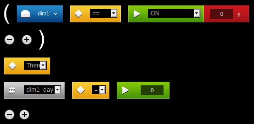

I'm a new user of Fibaro devices. I have a dimmer and motion sensor in the kitchen. Today in night i went to the kitchen and the light hurt my eyes.
So i created a variable day_night to choose the light level dependently, dim1_day and dim1_night values.
/monthly_2019_06/day_night.jpg.90372cb083753a24e408f530c00cdd44.jpg" alt="day_night.jpg.90372cb083753a24e408f530c00cdd44.jpg" />
Now I would like to change dim1_day and dim2_night values each time i set dimmer value by button or by HC.
But dimmer don't have a trigger "value changed" and the variable don't have possibility to get value from dimmer.
I want to have two time of day and light level memory. Is graphic block able to handle that basic behavior?

    I did it above. I even made a screenshots for you. Can I make light level memory - set variables when I set dimmer level - or not?
    See my screenshot. For day time you can use this also but change the variable value to day and dim value at 100 (or something else)
