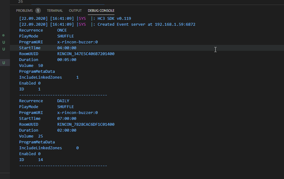

    btw, my Sonos displays ONCE, ON_, WEEKDAYS_, DAILY, WEEKENDS: depending on days combination, so consider adding check to your article/code. I did quick&dirty change to test:
    /monthly_2020_09/image.png.32537256e50f3141f3dc314a7c83a11f.png" />

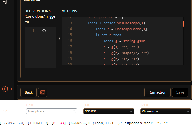

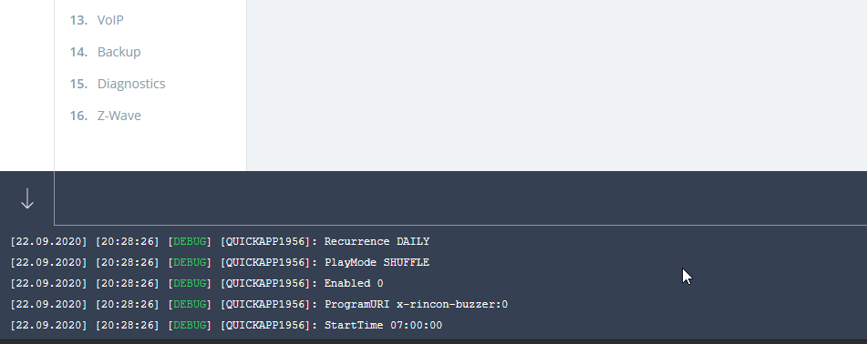

    Luckily i have no idea about anything, so added your code into HC2 scene:
    and into HC3 scene:
    OK! just trying to check
    like a charm :(

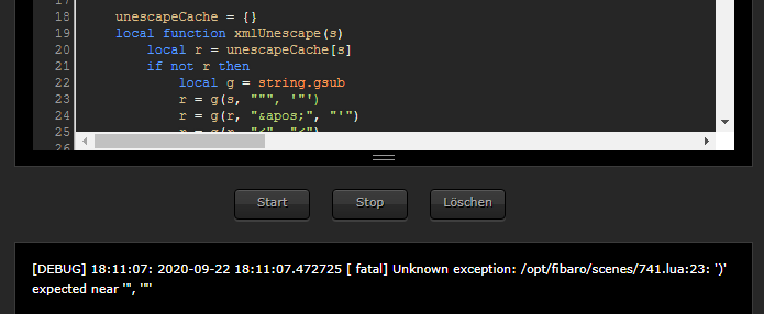

    /monthly_2020_09/image.png.d609e2a1315a6c7237a19e3a64b32c13.png" />
    4 minutes ago, tinman said:
    with the scene.
    OMG!
    ok just will test
    the code you pasted was broken, or got changed within forum editor, this is why. Got it now?
    /monthly_2020_09/image.png.c5de5ffdc02f987850f71189e51519bc.png" />
