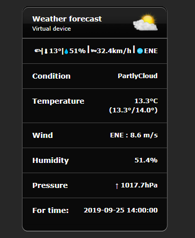

    here is my code for grabbing Yr weeather
    you can use it instead of using FIBARO.
    /monthly_2019_09/image.png.9d20b77705a9f6981339e2f959968da9.png" />
    btw
    Thanks, @10der. This is a little beyond what I was looking for. You seem to be grabbing Yr.no info directly from their web site. I was merely looking to decipher the variables and values available through the HC2 Yr plugin. I will look through the links you provided, though, to check that I have gotten it right.
