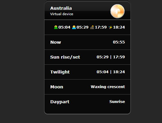

proofs
/monthly_2019_10/image.png.8115c7ba6efe55c1cf6146bb40cfc151.png" />
    @10der
    Thx very much.
    Wauw nice, looks good. but i get:
    [DEBUG] 12:03:35: 2019-10-04 12:03:35.630012 [ fatal] Unknown exception: /opt/fibaro/scenes/489.lua:6: attempt to call method 'getSelfid' (a nil value)
    When i put this in a scene.
    what am i doing wrong?
    @TSN1 You can remove line
    if you run it in sceene.
    it's quick modified my standalone VD :)

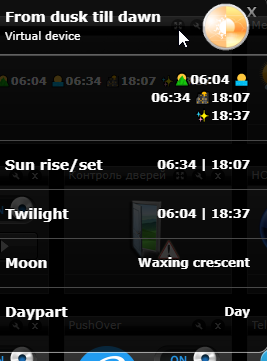

    that picture looks good :)   how did u get that VD out of that scene?
    and how do i make the Fibaro wall plug switch on and off at the correct time?
    Thanks for ur time and effort u put into this.
    Greetings TSN
    Greetings
    Quote
    too much questions :)
    create gloval vars
    SunriseExt
    SunsetExt
    SunriseTwilightExt
    SunsetTwilightExt
    now this vars will keep Australia sun times
    so. now you can use post by @jgab
    and use this globals as time for triggering ON / OFF your lamp
    it's easy
