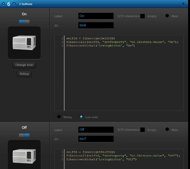

    @Jamie mccrostie  Unfortunately the statement doesn't work. There is no error in debug screen but the code just doesn't run in the corresponding button
    /monthly_2019_10/image.png.1dd4e08cb69cfbeb5bc3c2b3a9108426.png" />
    For the 2 buttons at line 6 they just update the state label to On or Off for better vision and update global variable
    The lua code to do that is
    fibaro:call(VDid, "pressButton", "6_1") for on, and
    fibaro:call(VDid, "pressButton", "6_2") for off
    Neither of above code press the button.
