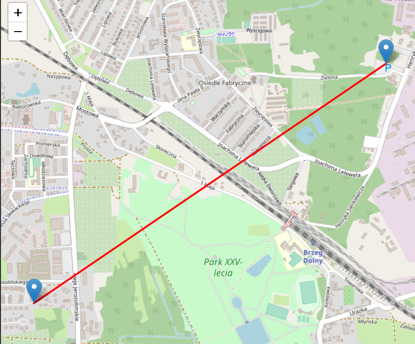

    I have set sampling every 1 minute.
    Here is my route, 3 km
    I think I'm a plane :)
