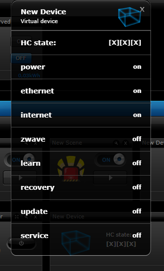

if you decied write wathc dog - replace 127.0.0.1
simple (sample) VD attached

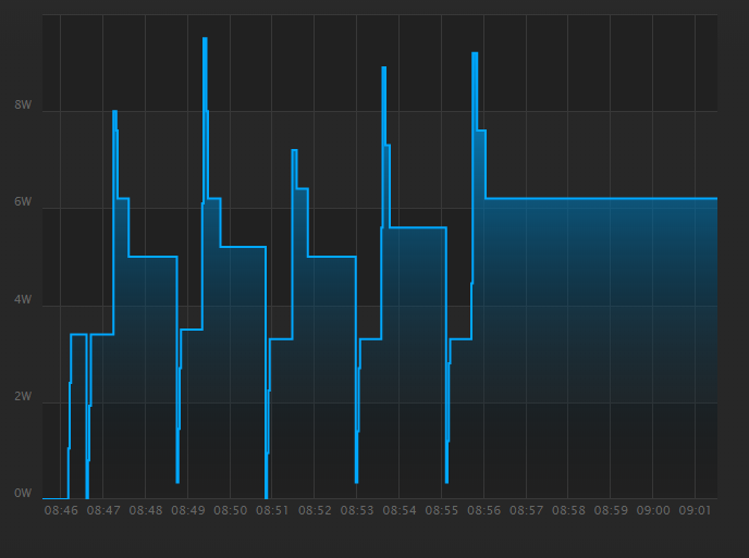

    I tried some changes and now it seems to work nicely.
    New port and a little sleep did the trick. You can see my power consumption graph below.
    At first my sleep probably was to low (60s) so it couldn´t connect. 120s seems to work and is good enough for me, maybe I´ll try a lower number later on.
