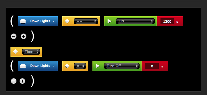

1. A run on timer when we have a shower I would like the fan to stay on for X amount of time after the lights have been turned off. This does work however if for example someone goes into the bathroom and turns the light on as soon as it is tuned off the timer starts. Then within X time if someone else was to go in and turn the light on and fan on it doesn't reset the countdown timer so the fan could turn off half way through a shower. Not really ideal.
/monthly_2020_03/1554133156_ScreenShot2020-03-26at6_59_02pm.png.aa518ac67c2162ca9ca75c2eb93e117a.png" />
2. I would like a 20min timer for most of my lights. Now this works ok for normal switches as I can set the max instances to 10 and they wouldn't; usually get pressed 10 times in 20 mins however the max running instances even being at 10 for the dimmers just doesn't work. If my kids go into their room and plays with the dimmer every time it gets changed it counts as an instance.
Basically I somehow need it to reset every time the switch is pressed and restart the countdown again.
