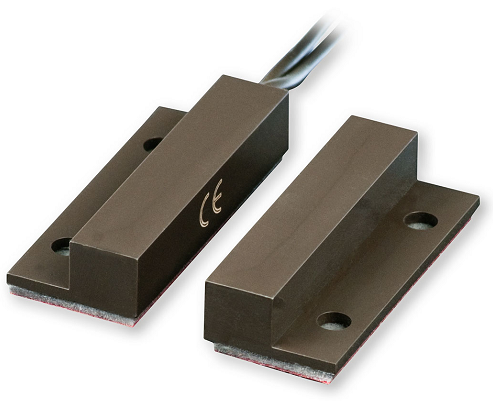

I would like to connect 4xbinary 2 wires window sensors to RGBW.

Does anybody could advise me if it is possible and how to connect simple magnetic sensors (2 wires) looked like:

Connect one leg of the sensor to GND and the other leg to "IN". An internal resistor on the FGRGBWM-441 will pull up the IN pin (I once measured it, input looks like a 18k resistor to 10.5 Volt). When the contact is closed, you'll see a low voltage, when it is open a high voltage, on your Home Center.
