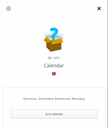

V2 - 07/06/2020 (UPDATED)
V3 - 08/06/2020 (UPDATED + fixes)
/monthly_2020_06/image.png.5d12ceba2fba6987be35ed36033a7c5f.png" />

no. use own calendar cuz this req ssl v3 what can't was implemented on hc2
@JeanOchmann Witam!
post updated - use QA
fix some issues.
please UPDATE
