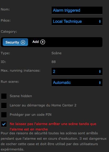

I'm having trouble for a few weeks now, with several scenes that do not execute when the condition is met.
They execute in manual mode, but not in automatic mode.

The scene is indeed in automatic mode :
