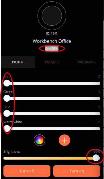

- There are constant errors appearing "application rejected request". I have never seen these errors before.

- you cannot specify RGB vs RGBW, so even when you have an RGB module the W channel is present and of course this can and does cause no end of problem - this is available on the RGBW1
- you cannot specify a white only led strip, so you will see R, G, B, and W channels for a white only led and this causes no end of problem until you rewire it to hack a workaround
- you cannot specify custom programs - this is available on the RGBW1 - it means you have to spam your network to get simple programs to work, which if you know anything about zwave, you simply will not do as it will crash your system eventually if not straight away. Think Christmas tree lights throughout the house => dead zwave network if you have to run it manually, rather than with programs
EDIT 2- another to add:
- Device polling does not work. I poll the device through LUA or through the HC2 BUI and nothing returns to the BUI i.e. the current value does not return
