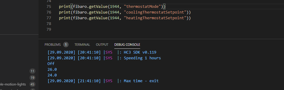

 The solution was quite simple.
1) settings
2) devices
3) +
4) popup -> Other device
5) QA
6)
/monthly_2020_09/image.png.c8397842d7bfb272894dccb7e07c1c66.png" />
7) Edit
8 ) reading header
-- * thermostatMode - current mode of the thermostat
-- * coolingThermostatSetpoint - set point for cooling
-- * heatingThermostatSetpoint - set point for heating
so
    1) settings
    2) devices
    3) +
    5) QA
    6)
    7) Edit
    8 ) reading header
    so

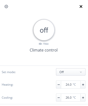

    7 minutes ago, szakos2094 said:
    Just a question ? Why I can't read directly the FIBARO heat controller adjusted value in this device ?
    well.
    lets go from the scratch
    do you know Id of your device?
    lets go
    http://192.168.1.36/api/devices/123
    where192.168.1.36 - IP adress HC
    123 - deviice (on your pic)
    please pur response (json) here
