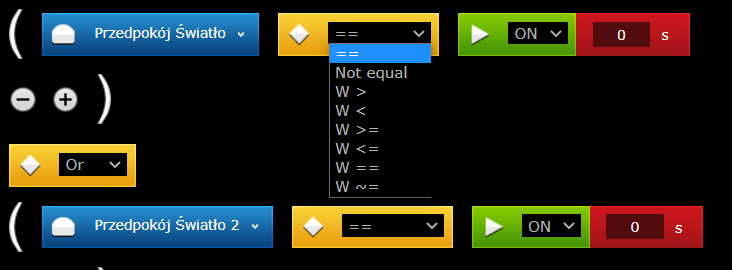

    I have tried to write those two scenes for "ON" and "OFF" from your example but they don't work properly. Lights are flashing on and off all the time.
    I have added predefined variable "active and inactive"
    (witch i don`t now how they work) what do they do in these scenes ?
    /monthly_2020_10/image.png.d93dbe3fcb203c3f64e09b616779cdec.png" />
    First of all the only choice i have got for Neo coolcam (called here "przedpokój światło" for light switch one and "przedpokój światło 2" for light switch two) are:
    =, not equal and W
    and ON or OFF.
    So now "toggled" to choose
    I cannot think of how these scene should look like, please help.

    The only choice i have got for Neo coolcam is:
    =, not equal and W
    and ON or OFF.
    /monthly_2020_11/image.png.6a81eefcc69332288edbb2c939ccd589.png" />

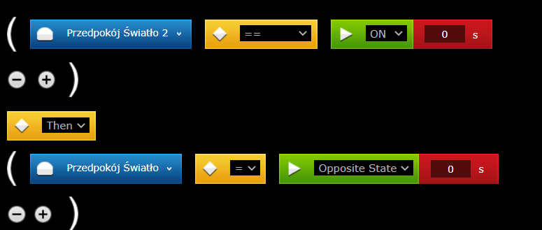

    Switch == On
    Then
    Light = “Opposite state”
    The “Or” should be “Then”

    There is only one light and two switches operating this light.
    Switch one called "przedpokój światło" and Switch 2 called "przedpokój światło 2"
    So how many single scenes ?Two ?
    /monthly_2020_11/image.png.af64b5d1902068994d30f30a31391544.png" />
    and
    Those scenes don't work properly. Sometimes you have to push the switch two times.
