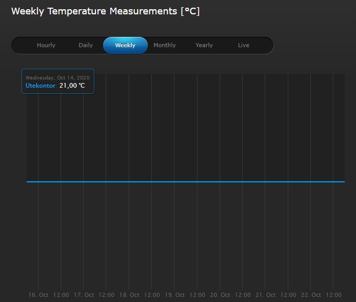

But the Z-TRM reports a constant temperature regardless of the actual temperature in the room.
None of the temperature sensors (internal and floor temp) ever change their values in HC2, even though
the thermostat is operating and I can see how the heater is turned on/off in HC2 power consumption panel.
Does anyone have a clue as to what my problem is?
Images below show the devices and the power/temp reports.
/monthly_2020_10/devices.jpg.381cab2782a3135f4dc956db61816578.jpg" />
(Device 198.3 is hidden since it is an external sensor that I'm not using.)
During this period, actual room temperature varied between 20 and 25 degrees C.

first of all set the association to multichannel only (unselect single, save refresh page, set multichannel again, save refresh).
Then set the group 3,4 and 5 association to your HC2
    Worked like a charm!
    Thank you!
