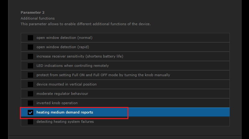

That is wrong way, I think.
You have to use Heat on demand option:
It doesn’t work very well, but it works.
    Thank you @Tomislav Barbarić, that worked without a line of code, thank you!

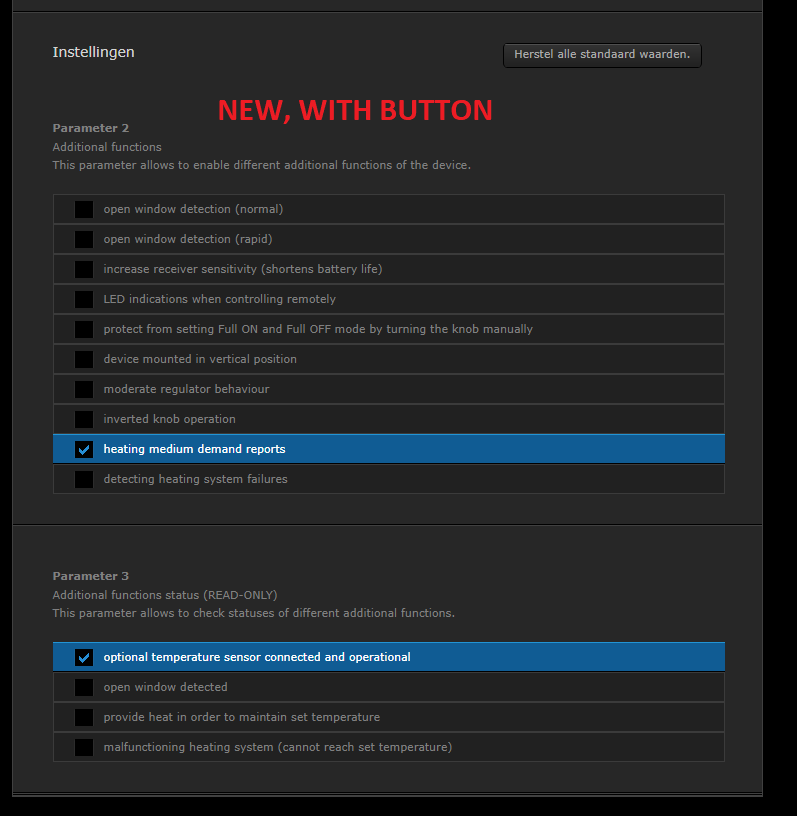

    Only 1 question left: i only can see the Heat Controllers with an button in the Heat-Controller-Add dialog.
    How can i add the (older) Heat Controllers to the list?
    The older one, which needs a key to press the button, doenst have a parameter2 "heating medium demand reports" option in the device itselve.
    Both type of devices identify as: com.fibaro.FGT001 with firmware 4.7
    How can i add those older controllers?

    Update the device to 4.7 and select reconfigure the device. After that the parameter will be shown
    I've updated both devices to version 4.7 and they turn up in the list.
    I've seen it working one time, but most of the time not.
    What am i doing wrong, and is there a way to see that is going on or to debug these components?
    /monthly_2021_05/image.png.daee7ba05994e131f4a596d8f773bbf1.png" />
    parameter is set
