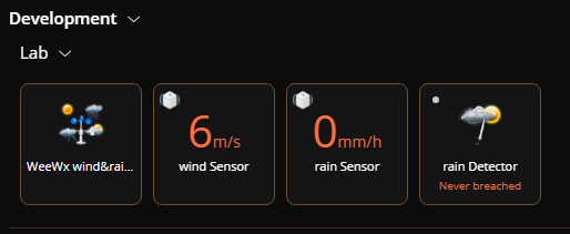

... and then try attached simple QuickApp. It will show (i think, i don't have WeeWx so tested with offline data) wind speed and rain rate, and the rain detector (if rain rate > 0) can be used as kind of alarm thing.

    that depends on the HC3 firmware version, on 5.80.9 it looks like (rounded to 6)
