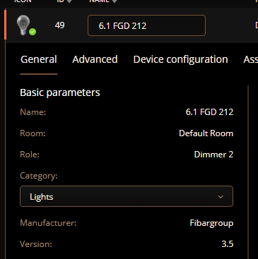

    generally one can, when the device does not support S0 as fallback, and does support S2A simply ignore DSK popup (let it timeout), then such device - when possible - included as non-secure, here exact the same device with DSK S2 key included:
    /monthly_2021_07/image.png.ab47650fbbe062e38e06b042052acc8a.png" />

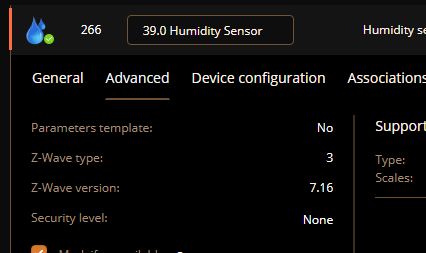

    and without security:
    Some devices does support - via parameters - configuration how they send associations in secured network, Dimmer2 is such device, see parameter 27.
