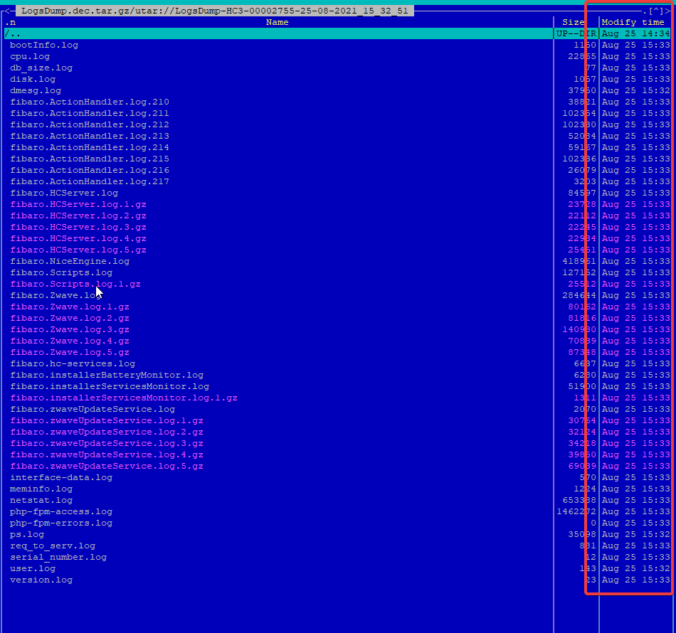

    PS: Michael, can you add --atime-preserve to preserve file(s) creation/modification date for logdump?

    3 hours ago, m.roszak said:
    Adding --atime-preserve will cause significant load on device memory and faster degradation of storage - that is not a good idea :)
    sorry
    you do not catch my idea
    you have
    /usr/bin/createLogsDump.sh
    in createLogsDump.sh you running command like
    tar -czvf file.tar.gz /var/log
    so i propose add
    tar --atime-preserve -czvf file.tar.gz /var/log
    why i am asking?
    cuz
    @m.roszak
    @m.roszak
    Edited by 10der
