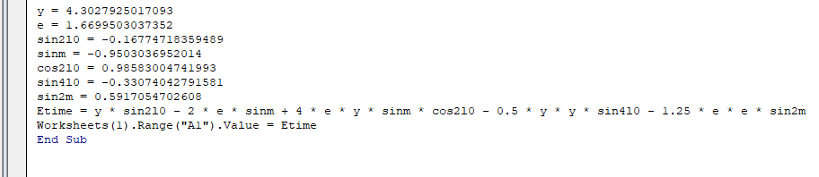

I have this code in vba Etime = y * sin2l0 - 2# * e * sinm + 4# * e * y * sinm * cos2l0 - 0.5 * y * y * sin4l0 - 1.25 * e * e * sin2m
which returns 2.19286480758148
However when i run this lua as follows Etime = y * sin2l0 - 2 * e * sinm + 4 * e * y * sinm * cos2l0 - 0.5 * y * y * sin4l0 - 1.25 * e * e * sin2m
I get a different result of -23.475237189689
Can anyone please guide me what I am doing wrong please?
Many thanks for any help provided.
Here are the variables with the correct numbers in both vba and in lua
y = 4.3027925017093
e = 1.6699503037352
sin2l0 -0.16774718359489
sinm -0.9503036952014
cos2l0 0.98583004741993
sin4l0 -0.33074042791581
sin2m 0.5917054702608

    in lua i am getting the same results as you howver in a spreadsheet running this code i am getting 2.19286480758148E-02

    yes i know i think i am loosing the plot here, i hvae enclosed the spreadsheet file i am working on as something is definetly wrong here
    i am trying to replicate calcEquationOfTime(t)
    and it gives me a different value then what you are getting and what i am getting something is very weird here if you replicate the Etime you end up getting a different value
