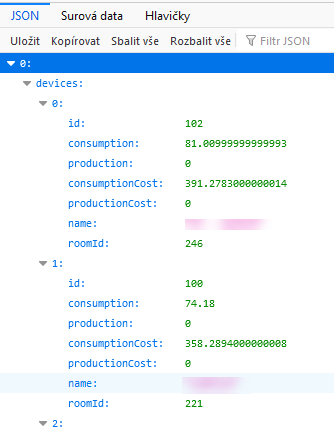

    For pulling energy data from devices (interface "energy" or com.fibaro.energyMeter devices) you can use new API from Energy Panel - you can sniff it using devTools on Savings Tab.
    There is no official documentation for it yet but it won't be hard to check how it works :)
    For simple summary of Hourly, Daily, Weekly, Monthy or Yearly energy consumption from the specific device you can use /api/panels/energy?id=x
