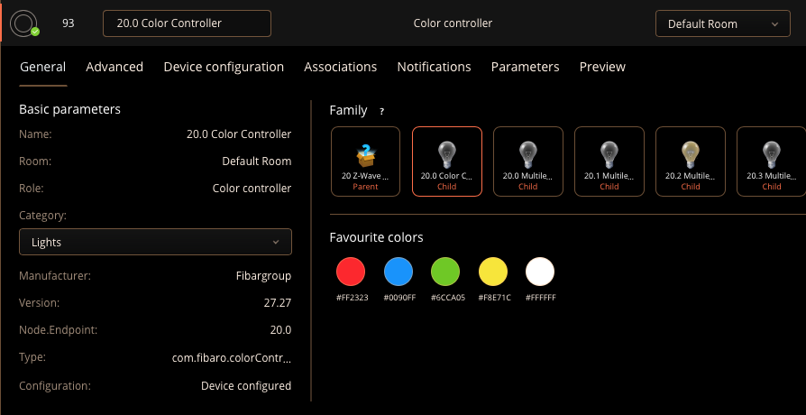

In my case, the 441 is being added as a “Colour Controller” and when I go to general settings the “role” is set as “colour controller” and I don’t have a pull down menu to change it
I’ve tried excluding & including several times. I’ve tried with another brand new 441 with firmware 25 and 27.27. I’ve rolled back to a previous firmware version on HC3 and the I’ve updated again to 5090.17 and retried. In each case it loads as a colour controller and I can’t change “role”.

You are using new Z-Wave engine (beta), right?
Old RGBW module is not supported there yet.
