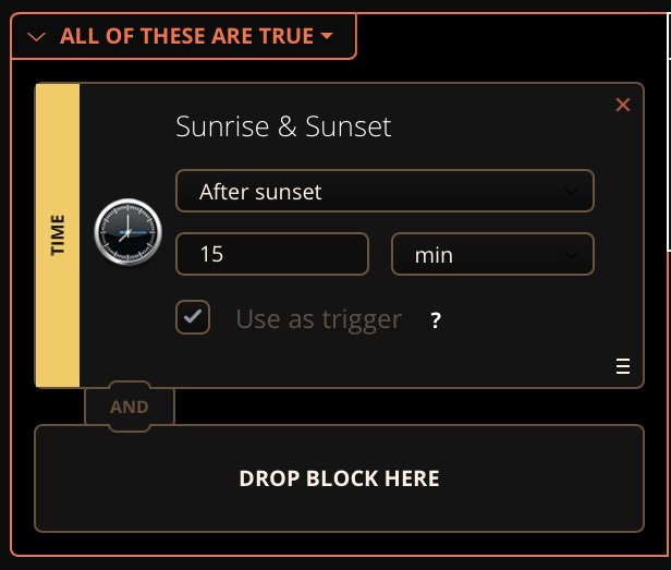

I am not sure this is the easiest way but it works for me.
/monthly_2021_12/A6803ABC-D7E2-4C44-BE98-71D734F4ED8A.jpeg.027f904129058b44c8eec2bf6a4279df.jpeg" />

    2 minutes ago, SmartHomeEddy said:
    Trigger / condition is not an issue and try to get it working in Lua :)
    A6803ABC-D7E2-4C44-BE98-71D734F4ED8A.jpeg.027f904129058b44c8eec2bf6a4279df.jpeg     79895D9C-2B39-4732-B3C5-AF5A1B90D149.jpeg.f15860479874515e3f0684830d3a90aa.jpeg
    1 minute ago, SmartHomeEddy said:
    That will give me the conditions in LUA. Which are not a problem in this case. Scene runs every minute.
    OK, just thought you wanted to turn on the lights 15 minutes after sunset.
