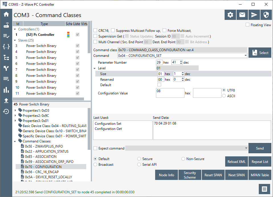

    I got it !
    It's just a matter of reading properly the documentation once we know where to put the values within PC Controller :D
    grafik
    So, as illustrated bellow, I simply had to:
    • Use the Command "CONFIGURATION_SET" from the "COMMAND_CLASS_CONFIGURATION" (and not the command SWITCH_COLOR_SET !!)
    • Use the parameter 41 as per the documentation, to set the color when the Wall Plug is off (or 42 when it's off)
    • Set the size = 1
    • Set the Configuration Value on the desired color, as per the documentation
