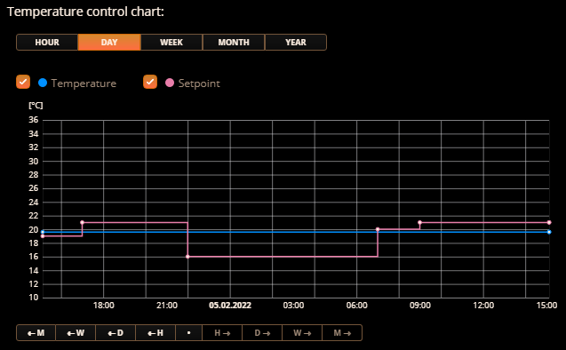

In some rooms, I have two or three FGT's that are paired with one single external sensor.
If you look at the temperature control charts, only the first FGT shows the measured temperatures.
/monthly_2022_02/image.png.38b5c5ccf90542f07b4d1f1b704179c4.png" />
The one or two other FGT's paired with the same sensor, only show a straight line:
It's the same behavior on all FGT's that share an external temperature sensor.

    After writing the initial post above, I did some more testing and I found the cause of showing a straight line for the second and third FGT paired to the same sensor.
    When I installed them, I thought: there is only 1 physical sensor and all 3 FGT's are in the same room, so I'll only show one temperature value in the panel, and hide the other two, to avoid clutter. So I set the (virtual) sensors for the second and third FGT to "device hidden" and "do not save events to history".
    In retrospect, that was wrong. The shared sensor is apparently considered by each FGT as "his" sensor, and all three FGT's need the events. In other words: to show the correct graphs, 3 FTG's with 1 sensor need to send the sensor value 3 times to the history.
    I guess it's not a bug, but a design choice.
