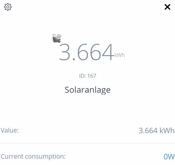

    Today the energy production calculation is again way to high.
    If you see in picture 1 there is a energy production peak about 2,7 kWh between 11 and 12 o'clock (and this seems the root of the problem). The maximum of my system is just 0,6 kWh and if you look at picture to you see the curve with correct numbers. BUT above you see number 4 kWh for the whole day is definitely wrong. I roughly calculated something about 1.6 kWh.
    On the other hand you see the maximum energy production for 2.5 days of my wall plug and this is just 3.66 kWh!
    So I've no clue why the system is calculating to much energy.

    and in QA the same value:
    At picture you can see that the curve of the QA is the same as the source data curve of the wall plug (blue line).
