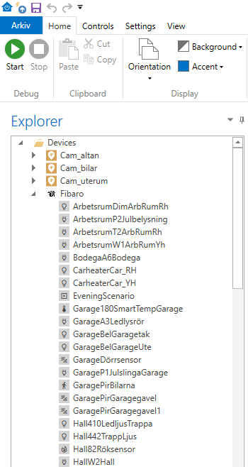

Home Remote is a great tool to create your own dashboard for tablet or mobile.
The app costs a few euros/dollars and applies to all devices linked to the same google account.
The app can be tested for free, but then a blue info bar appears at the bottom of the image. This field disappears when you purchase the app.
The Designer application where you create your dashboards is free to use. Designer also allows you to test drive your dashboard before uploading it to mobile or tablet.

    @Revan Yes, everything is difficult at first, but you quickly learn how it works.
    On the Home Remote forum you can get help and tips and Home Remote's creator Bill is very helpful. There are also a lot of examples that you can use.
    Under "Add Device Source" add Fibaro as a Device. Once you have configured the user, password and IP address, the Home Remote will create links to any device it finds in your Fibaro controller.
