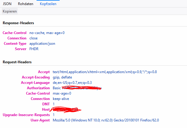

    Try this, it could work...
    Hello @jgab, thank you so much! Now response-status is 200. If you left a little bit time, what was my mistake?
    In addition i publish the final QA in the forum.
    Thanks once more!
    Thanks once more!
    You can't encode the user/pwd in the url. You needed to provide the authorisation header with basic authorisation credential.
    ok, thank you for your fast reply!

    Hello @jgab this request gives a full dataset of status:
    http://user:[email protected]/json?cmd=status
    /monthly_2022_08/image.png.d4ee97fac42b380b0b0f5f22350fa14f.png" />
    What if you add the missing headers to the http request?
    I wonder if the "upgrade-insecure-requests" is a sign that the call should be an https request.
    Could you also try to change the url to be
    ...if the extra headers don't help.
