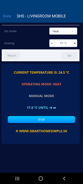

Anyone noticed, that after updating to beta, we have problems when updating button face, (or using visible not visible ) ?
It doesnt show the text but a boolean value. Any suggestion what to do? I am simply using self:updateView(id, "visible", true)

    I dont think that it will help you. This happens in YUBII only..in PC it shows correct values.
    This is the only, single line that is affecting this button on the picture...You can see, that it is correctly shown in PC, but differently / incorrectly in YUBII. Also ther is a lot other to discuss..as you can see, this is a quickapp - thermostats type device..
    (The other very frustratin thing is.that in PC you cant see the thermostat interface...(like see below on the picture), you can see only in YUBII...But this is jsut s side problem.)
