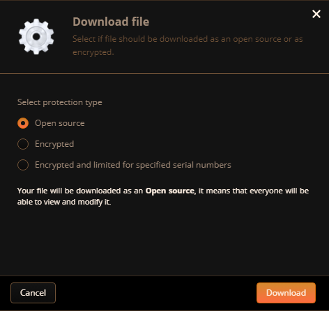

To encrypt you need the beta version, to use an encrypted quickapp you need the beta version also?
@SmartHomeEddy, I think yes. It has different suffix. It is .fqax.
@SmartHomeEddy
yes, the suffix is different, the data within the .fqax file of course ecrypted

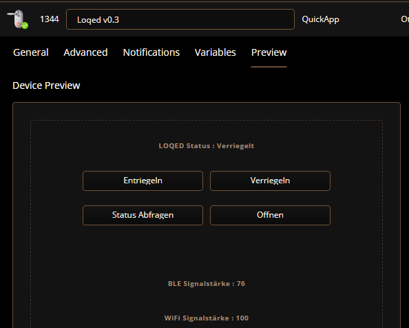

/monthly_2022_09/image.png.b448e1cbff38c95e3c9e7b31b543df70.png" />
to get decrypted there is runtime in the firmware since 5.113, so minimum level 5.113.
The physical imported .fqax file is of course still encrypted
Such encrypted QuickApp does have only "preview", not "edit&preview" tab. QuickApp Variables (in variables tab) can be of cours still edited.
The encryption happens during export, so you can chose between open source, encrypted for everybody and encrypted and locked to specific HC serial
